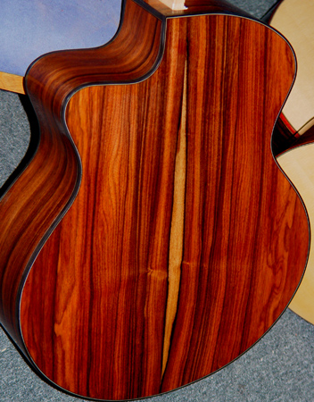

PostPosted: Mon Nov 28, 2005 6:07 am
Posts: 251
Pau Ferro!
How can you go wrong with this stuff??
PostPosted: Mon Nov 28, 2005 6:10 am
Posts: 267
Location: Brazil
Hi Russ..is that one of the sets you got from Brazil Tonewoods ???? That's a beautiful guitar..let's see more of it.Brazilwood38684.5921412037
PostPosted: Mon Nov 28, 2005 6:14 am
it's used a good bit. I have done two with it. tight pores, easy to finish.
PostPosted: Mon Nov 28, 2005 6:23 am
Posts: 785
Beautiful work, Russ. Pau Ferro is a nice wood, but that's no ordinary piece of Pau Ferro.
PostPosted: Mon Nov 28, 2005 6:32 am
Posts: 251
Jeff,
How did you guess???
Guys, if you are looking for nice Pau Ferro (like this), send an email to Jeff at Brazilwoods. Great wood and great service!

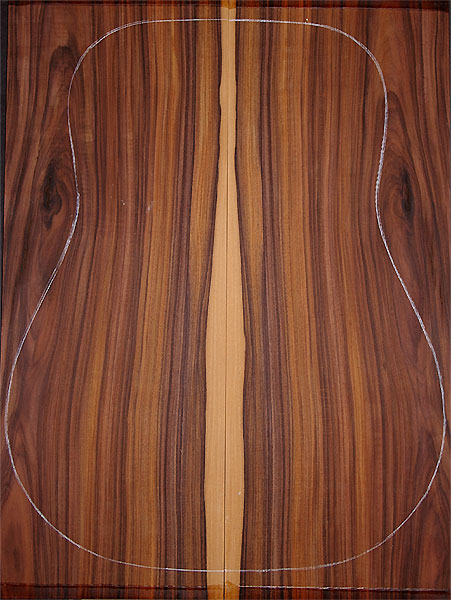

Kelby...actually that is a fairly ordinary piece of Pau Ferro if you know where to look. Russ has bought several sets from us and that one is fairly typical of what we sell. I just blocked out another cubic meter of Pau Ferro that is absolutely gorgeous..here's one of the back sets. This one has more of a chocolate colored look but, they vary from an orange tint to purplish...to chocolate colors like this one.
And the tap tone is amazingly sharp. I should have a lot of sets on our site in the coming days.
